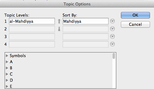

Also, this is not a text engine issue because which characters should be disregarded when sorting are determined by the user. This is a feature of indexing. I have already made this feature request for NWP.
This feature is available, for example, in InDesign. Here "al-Mahdiyya" will appear as such in the index but not under "a" but under "M".
