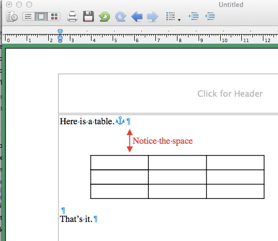

When placing tables into a document I need to apply 'space after' the preceding element as there is no means of applying 'space before' to the table itself. The same is true for space after a table... it needs to be simulated by setting 'space before' on the following item rather than being directly applicable to the table itself.

Actually you can "place" a table by dragging it (the whole table).

phspaelti wrote:Actually you can "place" a table by dragging it (the whole table).
Thanks... that's something I wasn't aware of and produces the sort of result I'm after spacing-wise... but it's applied one table at a time and by sight... With 20–30 or more tables it becomes a bit of a chore, as is achieving completely consistent results on each table.
Ideally though I'd want the ability to attache this gap to all tables automatically by means of a table-style... that could also set borders, background colours and so on...
