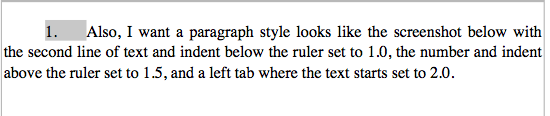

1. Also, I want a paragraph style looks like the screenshot below with the second line of text and indent below the ruler set to 1.0, the number and indent above the ruler set to 1.5, and a left tab where the text starts set to 2.0. I can’t get this style ‘to stick.’ (The ‘My List’ and list.zrtf file didn’t show this exact format but instead showed a number followed by a block indent of text.)

foster13 wrote:Also, I want a paragraph style looks like the screenshot below with the second line of text and indent below the ruler set to 1.0, the number and indent above the ruler set to 1.5, and a left tab where the text starts set to 2.0. I can’t get this style ‘to stick.’ (The ‘My List’ and list.zrtf file didn’t show this exact format but instead showed a number followed by a block indent of text.)
The problem seems to be that you are trying to define the list style like that. You should instead define a paragraph style with those specifications. Then attach the list style as one of the attributes of the paragraph style. LIst styles are really intended for numbering purposes only.

foster13 wrote:I want a paragraph style looks like the screenshot below with the second line of text and indent below the ruler set to 1.0, the number and indent above the ruler set to 1.5, and a left tab where the text starts set to 2.0. I can’t get this style ‘to stick.’
This configuration is possible by having your paragraph style enforce a tab stop at 2" on the ruler. So you'd have:
1. A first line head indent of 1.5"
2. A tab stop at 2"
3. A hanging indent (wrapped line indent) at 1"
I'm attaching a sample file that shows this.
list.zrtf
(2.69 KiB) Downloaded 314 times
However, I did run into a bug while attempting to produce this example: if the tab stop is exactly 0.5" after the first line head indent, it is incorrectly removed when reopening the file. So for this example I set the tab at 2.02". We'll have to get this fixed.

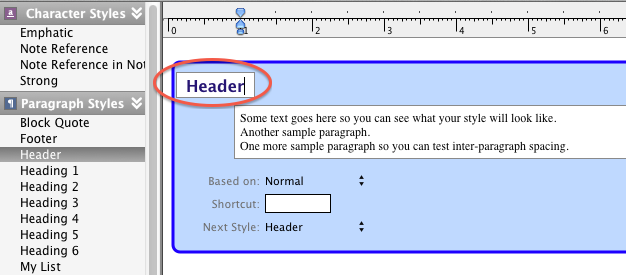

Of course. As Philip says, you do so using the Style Sheet (under the View menu). You'll want to select the style from the list on the left, and then on the right enter the name field:
