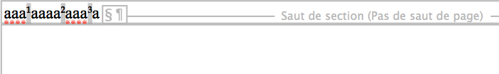

The macro make a section break and insert a note but i can't see the note himself
i'm so sorry for all the work you make for me and i adress you a million thank's

oupsss i forgot to put a end paragraph before running the macro, it goes perfect now
