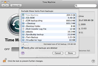

Try the experiment with the files attached herewith. Open Bug test.rtf then drag timemachine.jpg where indicated - the text line above the large rectangle. When I do this both images move to a second page, leaving a blank page above them; converting the smaller image to a floating one causes it to disappear and the document to revert to a single page. (I'm on Mavericks, if this makes any difference). (The content of the Time Machine image is irrelevant, it was just conveniently to hand.)
