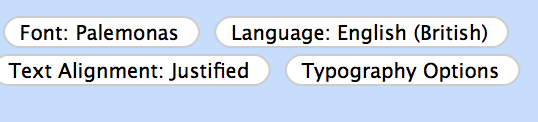

I continue to struggle with ligatures. I'm using NWP 2.1.3. I save a document after having applied Ligatures > Use None to the entire text. When I re-open it, that setting is gone. Even putting "No ligatures" in the paragraph style doesn't seem to "stick." You must re-apply the paragraph style for it to remove the ligatures. I think at least part of the problem is with the font (it somehow has ligatures on by default), but I need to use this font. Ideas?
The font can be found here, if anyone else want to try it: http://vlkk.lt/palemonas
Re: Bulk change of ligature setting in fonts?
You should uncheck ligatures from the Typography panel for your Normal style from the Format:Font:Show Typography Panel menu. Note that some text in Normal style with only Palemonas font applied must be selected for the font's typography options to be revealed.) Then redefine your Normal style from the selection. This will add the "Typography Options" to your Normal style in the Style Sheet.
Common Ligatures.png (36.49 KiB) Viewed 36288 times
Typography Options.png (20.48 KiB) Viewed 36288 times
NisusUser
Posts: 335
Joined: 2011-01-12 05:32:38
Post by NisusUser »
Hamid wrote:You should uncheck ligatures from the Typography panel for your Normal style from the Format:Font:Show Typography Panel menu. Note that some text in Normal style with only Palemonas font applied must be selected for the font's typography options to be revealed.) Then redefine your Normal style from the selection. This will add the "Typography Options" to your Normal style in the Style Sheet.
Thank you, Hamid. This does seem to work. :)
