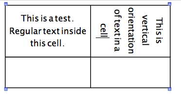

Nisus Writer Pro 3 does add support for vertical text orientation, but only within table cells and floating text boxes. If you activate vertical mode for such a text area, the text will indeed flow from right to left like so:

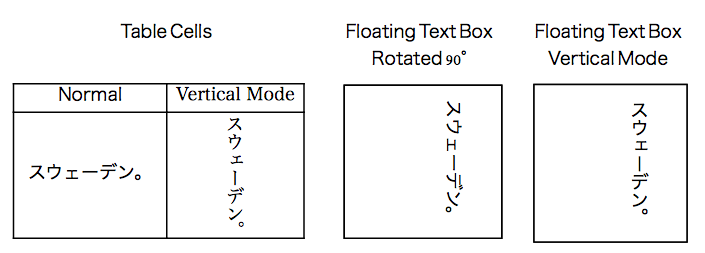

I wasn't referring to merely rotating text. Nisus Writer Pro 3 has a proper vertical text mode via the menu Format > Vertical Layout Orientation.
Philip, when you say the individual characters are rotated for columnar CJK text, you mean the punctuation marks right? This is what Nisus Writer Pro 3 can show for vertical text mode inside table and text boxes:
Is the text using vertical layout orientation not correct?

Floating text box, vertical mode, looks good.
I don't see it when I type "floating" or "vertical," but I found it in Tools => Insert Shape => Box.
At that point, though I don't see how to move to Vertical Mode. Thanks for pointing this out to me — I'd like to play with it.

Hello Martin, thank you for the reply. I guess I was misled by your first example with the western text. I wrote without testing this myself first, so I had no idea that this was possible. The vertical text works for Japanese text, exactly as it should, with columns wrapping right to left, etc.. So my earlier comments should just be ignored.
Having tried it (for 2 minutes now) I can say the following.
  • It works!
  • It works in tables and text boxes only (of course)
  • Line spacing (set to 1 line) is incredibly tight
  • Trying to edit/write in vertical mode would take some getting used to. Better to write in horizontal mode and switch to vertical when finished.
  • A quick test had vertical text spilling out of the box. (A bug perhaps?)
  • While editing, changing the box size, etc. text will remain in strange, cut-off blocks at times, but ultimately adjusts itself

branner wrote: ↑2018-10-30 16:55:00At that point, though I don't see how to move to Vertical Mode.
Once you have a table cell or floating text box, you can enable vertical mode by selecting any text inside and using the menu Format > Vertical Layout Orientation. That will apply vertical mode to all text inside the table cell or text box.
