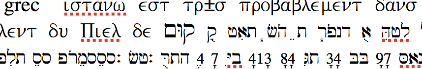

Re: character recognition
See this for an example
The first greek verb is ok Thant everything appears in Greek characters. If not by you, this would mean I do have a specific problem on my machine. Sorry for doubling the thing.
- Screen Shot 2019-02-11 at 16.51.50.png (52.61 KiB) Viewed 24917 times
then the first word in Hebrew is ok and the rest comes with Hebrew characters.
