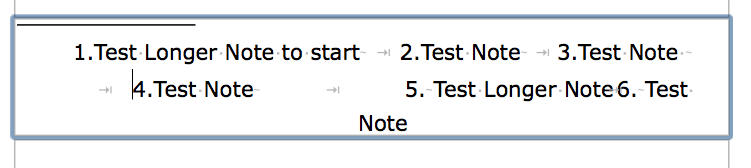

But the problem is I have several pages that require two or more lines of these footnotes; and it ends up looking like this:
Problem with spacing second line of centered Footnotes.png (25.06 KiB) Viewed 11748 times
It turns out that Nisus applies the SAME tabs on all the lines, so on the second and later lines also. Spacing looks wonky on those lines.
I’ve read the manual and tried this in multiple different ways. Changing styles doesn’t help; using paragraph returns at end of first line doesn’t help.

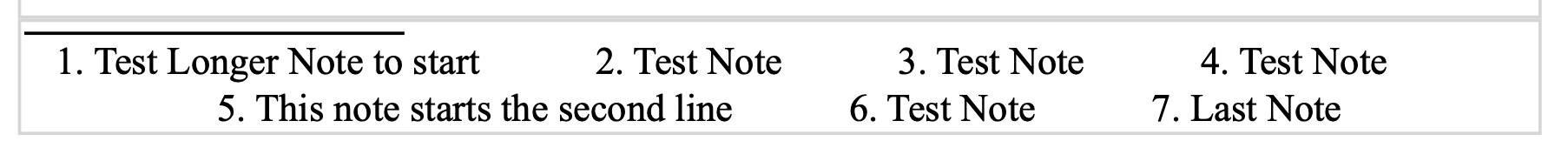

However, Nisus Writer Pro version 3 does have a new option that might help you. When you enable "multiple notes per line" you can now choose an automatically enforced horizontal spacing amount that is fixed between all notes. Here's an example of the results:
You can see the notes have the same horizontal spacing between them. There's no need for you to configure tab stops on the ruler.

martin wrote: ↑2020-12-14 13:27:01 However, Nisus Writer Pro version 3 does have a new option that might help you. When you enable "multiple notes per line" you can now choose an automatically enforced horizontal spacing amount that is fixed between all notes. Here's an example of the results:
Martin thanks,
and forgive me for being picky. But my concern is with centering.
I note that, strangely, your example looks like the centering is not correct between the two lines.
I mean, if that paragraph is centered, why are the left and right edges of the two lines not arranged around one common center (the center of the page)? The second line is indented more, so it doesn't look like centering.
I'm concerned I may merely switch problems in V 3, and still not be able to center all the lines.
My guess is that the enforced space between #4 and #5 is being carried to the start of #5, and being counted there as the start of the line. Is there are workaround that could fix this?
