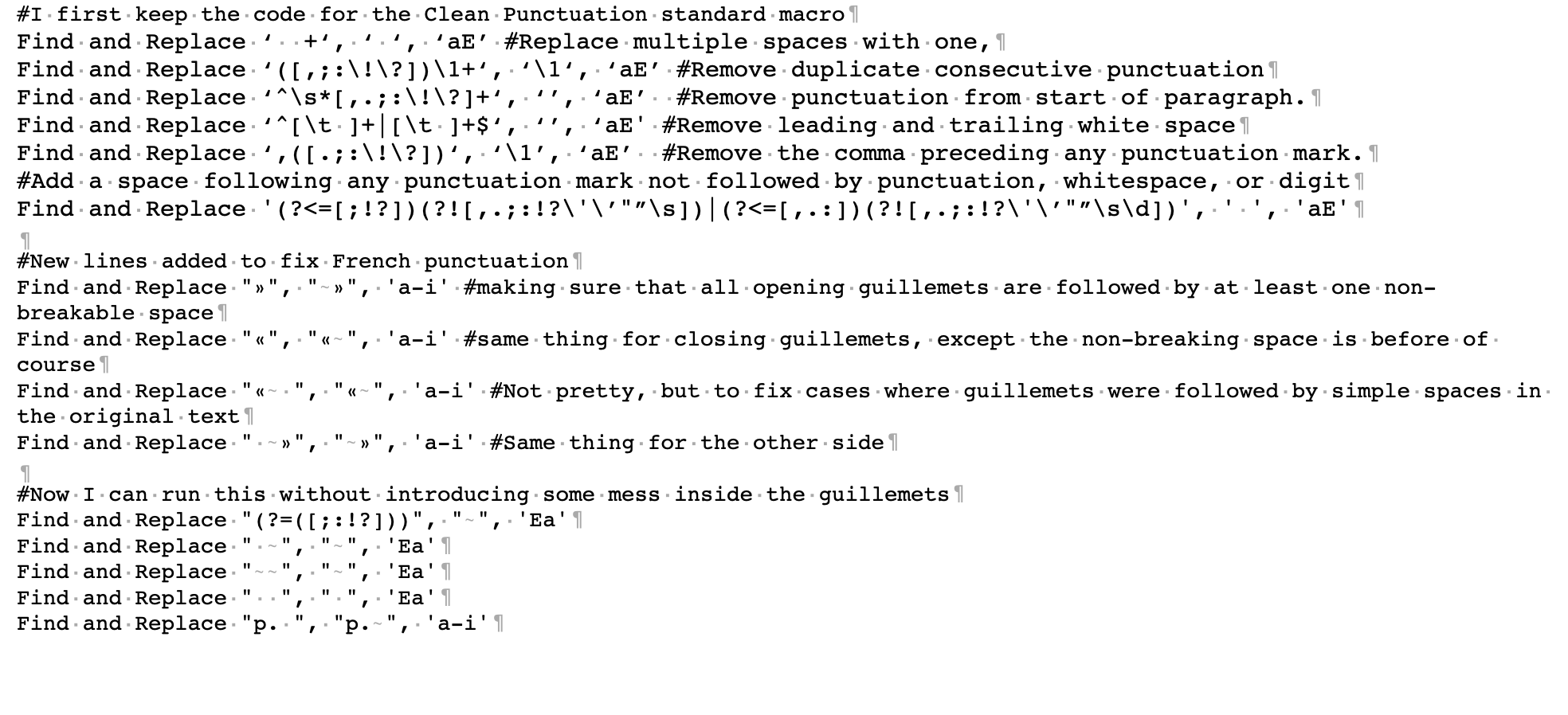

I know it might sound too basic for some users but I decided to check the present state of the macro. It's not pretty but it does the required work, if you see some way to make it more compact, don't hesitate. When we work on texts where a part is in good shape and some other part contains errors, I see no other way of making sure that the process does not introduce more errors.
I insert the screenshot since non-breaking spaces disappear when I paste in code. My plan is to implement other very common fixes and to share the macro, if others are interested of course.
Capture d’écran 2021-06-02 à 22.28.19.png (249.91 KiB) Viewed 23576 times
Out of curiosity, if power users read this: the fix for the "p." (pages) before page numbers is not good. I might end up with words ending with a "p" and followed by a non-breakable space. I would need to find all occurrences of "p. " which are just before any number and just replace the with p.+non breaking space without selecting the said number. I can find no way of achieving that with the Powerfind...
