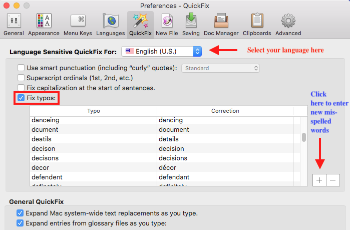

Nisus has already a feature which should prevent you from misspelling the same word over and over again. It's in the Preferences and is called QuickFix. Enter all your misspelled words there with the corresponding corrections. Once you have done that the mistakes will be automatically corrected when you mistype words. — The word list is language sensitive, which means, your QuickFix words are only corrected if they match the language of your text. This is a boon to those who write in many languages.
