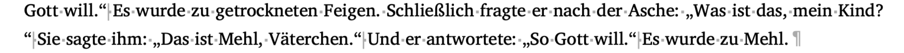

There is an annoying bug in Apple's text engine: sometimes a closing quotation mark stands alone at the beginning of a new line instead at the end of the preceding line. This problem occurs in German texts, perhaps also in other languages.
Martin suggested at <viewtopic.php?p=31085#p31085> a solution for that problem: a zero-width space or a zero-width non-joiner character, placed after the closing quotation mark. That indeed helps in most cases. But there are some rare cases, where it does not help, see snapshot below (after every closing quotation mark is a zero-width space inserted).
How can I bring the closing quotation mark to the preceding line or the last word of the preceding line in the next line? The text is aligned justified, therefore a soft return before the last word is no solution.

You attached a PNG file rather than a text file. I opened it in Preview and was then able to extract the text and paste it into an NWP document. There appears to be a paragraph return immediately preceding the closing quotation mark following "mein Kind?". This would explain why the closing quotation mark was not "stuck" to the preceding text in this instance.

Enclosed I add a text snippet with a wrong closing quote. You need the Font Charis SIL to view it. Then you can see, that there is no return before the wrong closing quote. Do you really think, I am so stupid? Or did I understand something wrong?

The other forum topic that you referenced actually talks about the opposite problem, where a final word and its following closing quote mark wrap too early, but all together. Your situation is not like this. Your problem is that the close quote mark wraps on its own and leaves the final word on the prior line by itself.
The solution you are looking for is the zero-width joiner character (not the non-joiner character). You will want to insert the joiner between the final word and the quote mark, in the exact place where the unwanted wrapping occurs.
