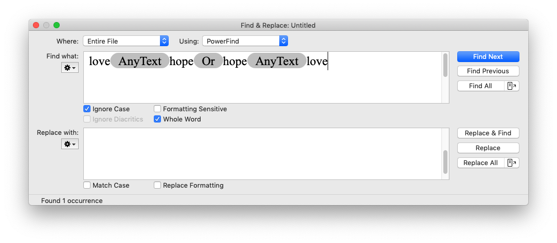

The point is that Find is not a search engine looking through a database, it's a pattern matching algorithm. So an "AND" search in this case would be a search for string1 followed by string2. In the simplest case you just type them both into the find box. but of course that would require them to be immediately adjacent to each other. To allow them to be separated you will have to put a wildcard in between them. So your expression will say string1 wildcard string2. Your choice of wild card will depend on what you want to allow to intervene between the two. For example if you use the Any wildcard, the search will match the first instance of string1 and then your entire document up to the last instance of string2. If you choose Any Text then your search results will be limited to instances where string1 and string2 are in the same paragraph.
Finally if you don't care about the linear order of string1 and string2 you'll have to do two searches, which you can combine using OR.
So a search for all paragraphs containing both "love" and "hope" would look like this:
Screen Shot 2019-01-18 at 14.38.14.png (106.57 KiB) Viewed 10966 times
