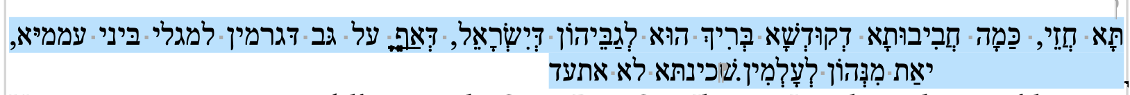

since the new version of NWP, i got issue in hebrew with some fonts (as it work well with Word or Mellel)
here's a screen shot
if someone's can help

Could you be more precise about the exact nature of the problem? It looked to me like the font was fine, but the nekudot stopped in the middle.
While I don't know if this is relevant to your issue, but I generally use New Peninim when I need nekudot.
And I also saw what you might have been referring to: the end of the sentence has the first words at the end following the period. If that's the issue, it looks like a right to left formatting error.
The text is from the Zohar and the one I looked at had one word that yours didn't. Where are you taking the text from?

the nekoudot are not in place
the paragraph dot is not correct etc
with the same font and the same text on Mellel or Word i don't have this issue
so the issue is from NWP

So I thought the font is Times New Roman which is what is listed under the screenshot.
I made a mistake: the quote as msebban had it doesn't have an extra word. Rather, one of the words is split in half. So what is after the period should be before it.

I downloaded the document. When I removed your underlines from the text, indeed the nekudot were missing or inaccurate. However, when I changed the font to New Peninim, all the nekudot were in their right places.
I have had this issue myself. For whatever reasons, Times New Roman doesn't seem to recognize nekudot consistently. I tried doing the same for a biblical verse taken from Judaic Classics and had the same issue with Raanana, even though I didn't have it with either Times New Roman or New Peninim. I also tried copying and pasting text from Safari and did not have your issue with either New Peninim or Times New Roman.
So, even though I'm not clear as to why this is so, try changing your font to New Peninim and see if you have the same result that I had.
Again, this may be the fault of the source document. If you are using an online source, perhaps you could direct me to it and I'll see if I have the same result you have. I don't use either Word or Mellel, so I can't fully repeat what you did. It looked to me like your source was the Chok l'yisra'el and I found it online but couldn't duplicate your problem. I'm also using the most recent version of NW.

One more thing: In the file you sent me, the last line was in a font call Narkisim, which is not in the list of fonts. When I changed that to Times New Roman, the nekudot no longer worked, as they didn't for you. But when I changed it to New Peninim, the nekudot were restored. When I tried Raanana, again the nekudot weren't correct.

yes the issue is with Time New roman and perhaps other fonts
But with Times New Roman (same font) in Mellel or Word, the nekkoudot are fine with Times New Roman
so there's an issue in NWP with Times New roman and probably other fonts
