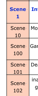

Thanks and that's great but introduces a new problem: the sort of the Scene1 etc. doesn't return to that order. Apparently the re-sort doesn't follow the numbers correctly.
That is, the main reason I want this scene # list is so I can re-sort to that sequence after I've sorted for '# of words' or any other criteria.
But after I downloaded and ran the macro, which beautifully made a list of Scene numbers in column 1, when I:
a. Sort for number of words.
b. Then sort again for Scene # to return to sequential, I get:
Resort of 1st column -- Screen Shot 2019-07-09 at 11.33.14 AM.png (15.31 KiB) Viewed 40860 times
As you can see, the numbers do not sort correctly, since they should go from 1 to 134, in sequence.
Can this macro be edited to produce numbers in a way that will sort in sequence in the table?
I don't really need the word 'Scene' at the start, would tha help? Or using 1.1, 1.2, etc.? Or some other workaround?
wF
Re: Automatic numbers lost in sort Table
withoutFeathers wrote: ↑2019-07-09 10:41:14 I don't really need the word 'Scene' at the start, would tha help?
Exactly. "Numbers" of the form "Scene 1" are sorted alphabetically. So "Scene 101" will precede "Scene 25" which will precede "Scene 9". They would need to be 0-padded to sort correctly. But if you remove the "Scene " then they will sort as numbers.
