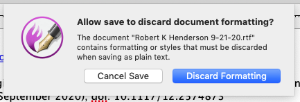

Lately when I try to save new files (that have not already autosaved into the Nisus folder) I can create a file, but when Nisus Writer Pro (3.0.4) tries to autosave, I get an error message "Allow save to discard document formatting?", as shown in the attached screen shot. https://nisus.com/forum/download/file.p ... id=2054The default file type is set as an RTF, yet it seems to be trying to default to a text format. I am also attaching screen shots of the Saving https://nisus.com/forum/download/file.p ... id=2052and New File Preferences https://nisus.com/forum/download/file.p ... 053because this little big may be related to one of them. [attachment=0]Autosave wants to discard formatting.png[/attachment]
Any idea what's causing this and how to fix it? It does not happen if I let Nisus autosave it in the default Nisus folder, but that's not where I want the files to be. For the record, I am on a 2018 MacMini running MacOS 10.14.6
Thanks, Jeff Hecht

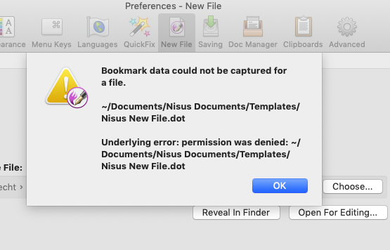

That's very strange, and I'm not sure what would cause that problem, but it certainly could be related to problems with your New File template. That seems like a good place to start in trying to fix this.
One question regarding the error alert shown in the New File preferences: when does that appear on screen? Have you tried reselecting your template file using the "Choose" button? Is that when the error is shown?

I have tried to reconstruct how I got the error on the New File template, but have not yet succeeded. I did look at the Template File listed under Advanced preferences for a New File and picked Nisus New File. I think (but am not sure) that it might have been set for "Plain Text Template" before. That may have been the problem; after picking Nisus New File I was not able to reproduce the saving new new files error.

It sounds like Nisus Writer lost access to your Nisus New File template, which incorrectly triggered the alerts about discarding formatting. That isn't exactly how it should work. Nisus Writer should have alerted you to the fact that your template was inaccessible at the moment you created a new file. However, if a new document window was somehow created, but the source template was inaccessible, I could see how maybe Nisus Writer got confused as to the file format of the new document and somehow incorrectly defaulted to plain text.
Either way, I'm glad you resolved the problem Jeff! Reselecting your template file almost certainly fixed the issue. That act triggers the system to restore permission for Nisus Writer to access the file.

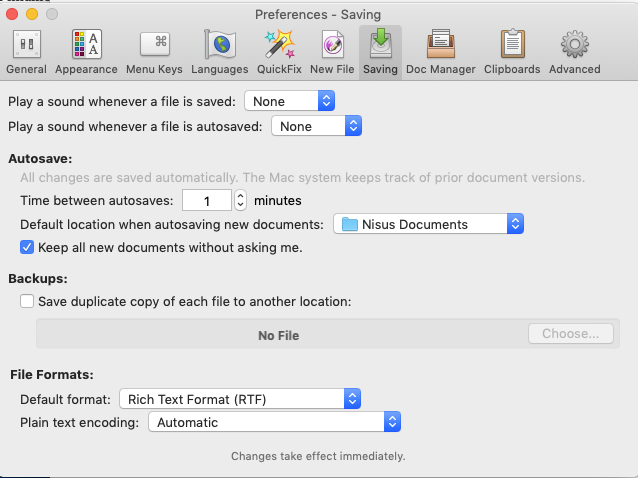

One question - when I checked the "Saving" preference pane, the "File Format" at bottom lists the default format as "Rich Text Format" and the Plain text encoding as "Automatic". I note that UTF-8 is "recommended". Might changing that to UTF-8 make a difference?

I very much doubt that will change anything.One question - when I checked the "Saving" preference pane, the "File Format" at bottom lists the default format as "Rich Text Format" and the Plain text encoding as "Automatic". I note that UTF-8 is "recommended". Might changing that to UTF-8 make a difference?
The nature of the problem seems to be that Nisus Writer loses access to your New File Template, which incorrectly triggers Nisus Writer to default to the plain text format. That change in the decided file format is a Nisus specific issue, and I'll have us take a look to see what we can do about it.
However, the root cause of the problem is the lost access, which is something the system (macOS) maintains. That's probably why rebooting your Mac tends to trigger the issue. I expect that the reboot is incorrectly resetting some system data and/or settings, which means Nisus Writer is incorrectly denied access to your template. That's something we can't fix, as it's part of Apple's security apparatus. The system is naturally in total control of this, to ensure rogue apps don't access your data without your permission. That's generally good, but it also means there's little we can do when something goes wrong.

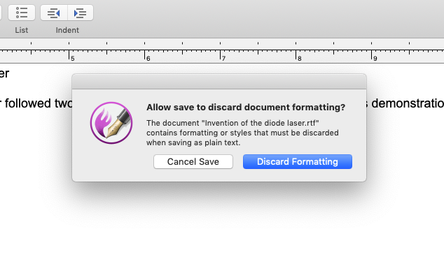

So what should I do to stop this? I just had it happen again. I copied and dragged and dropped some text from Firefox, saved the file the first time, and then was told it could not safe formatted text.
This time the only error message I get is the attached which tells me nothing other than I can't save the file. Am I missing something.

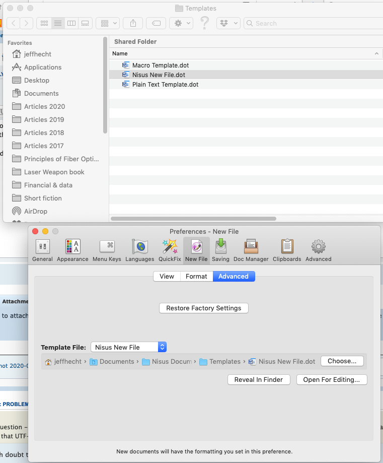

FWIW, I had Plain Text encoding set as "Automatic" I can find the NWP seems to be able to find the New File, as shown in the attached.
I tried a Save As of the document again with a new name, left it for a minute or two, remembered I should have added something, typed in a couple of spaces, and this time it autosaved without objection. I feel like there's some magic spell I've forgotten to invoke, but it feels more like I am trying saving something that gives NWP digital indigestion and it can't swallow...er, save... the file.
Any ides would be welcome. Thanks for trying.

Re: Problem in saving new files
I would recommend the same thing as before, which is to reselect your Nisus New File template. Even if the Advanced area of the New File preferences shows the correct file, you should click the "Choose" button to confirm the existing file. That should make the system grant Nisus Writer access to the file again.
