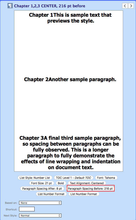

Meanwhile line height is arbitrarily capped at 100 points, so that's not a workaround
This is a misunderstanding. It's true that the arrow counter in the Paragraph palette stops at 100, but you can enter 216 manually into the Space-Before-box (and then hit Return) if you want 3 inches, like you mention here:
<https://www.nisus.com/forum/viewtopic.php?t=5089>
I think 3 inches is equal to 216 pt.

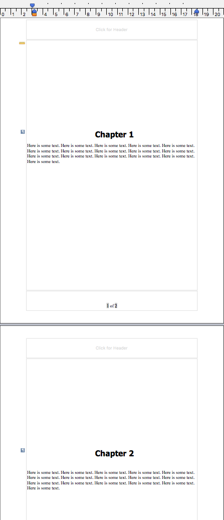

Here is what I did:
1) I turned on the Vertical Ruler and chose Inches (in)
2) I created a Paragraph Style called 'Chapter 1,2,3 CENTER, 216 pt before' which, when applied, automatically enters the word "Chapter" and a list number which increments by 1, hence the name 'Chapter 1,2,3. Make sure the next style is set to be Normal! You can of course get rid of the empy line by implementing Space After in the Paragraph palette, but I guess that's six of one and half a dozen of another.
3) Then I created a simple macro to enter the style.
Page Break
Type Newline
Format:Paragraph Style:Chapter 1,2,3 CENTER, 216 pt before
Type Newline
Type Newline
To enter the 1st chapter, you just apply the paragraph style manually. After that, every time you finish a chapter, let the insertion point reside at the end of the chapter and then run the macro.

Þorvarður wrote: ↑2020-02-03 02:09:25 I think 3 inches is equal to 216.
150 pt looks more natural (than 216 pt) to me, but you can of course change it and use whatever size you think is best.
