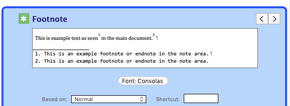

I've now done what you suggest, but my Footnote style (not the "my footnotes" paragraph style) has a Font selected which I cannot deselect (see the screen shot: "Font: Consolas").
(Of course I could simply change the selected font to the font as used in the "my footnotes" paragraph style, but I feel this shouldn't be necessary.)

shmuel wrote: ↑2020-03-03 09:07:38 my Footnote style (not the "my footnotes" paragraph style) has a Font selected which I cannot deselect (see the screen shot: "Font: Consolas").
Just click the formatting bubble (for the Consolas font) to select it, and then press the Delete key. That will remove the formatting override, so the font is inherited from the parent style (Normal).
Or select the Footnote style and change the font to the desired font, using any of the usual formatting tools, eg: the font menu.
