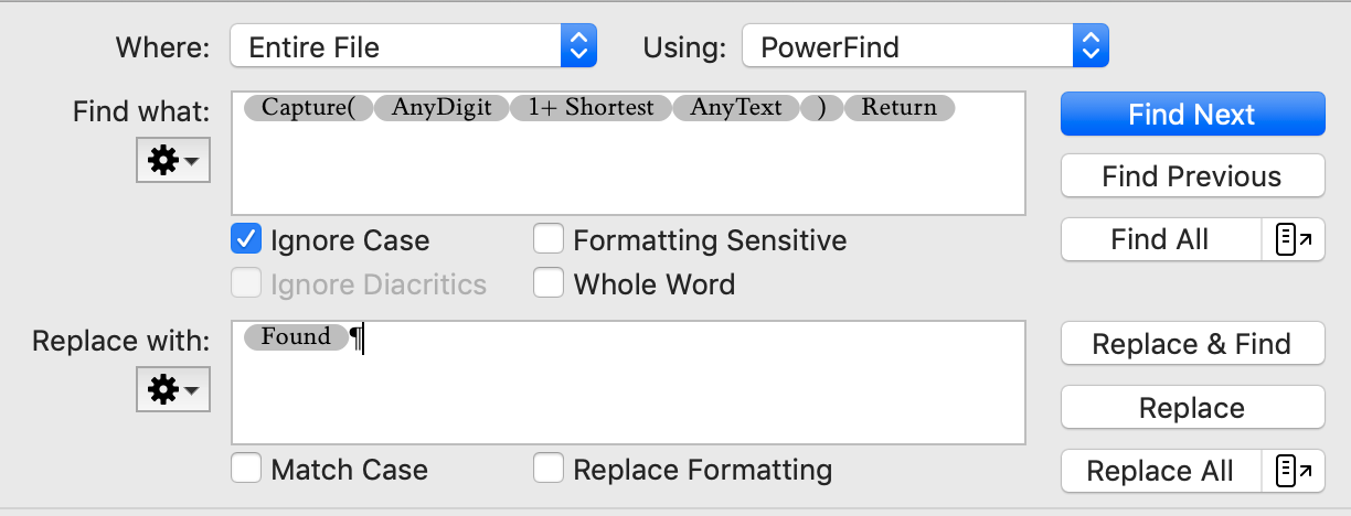

Hi, once again,
I need a way to find all returns in footnotes and replace them with pilcrows. What I want to do is make it so all the text in every footnote is only one paragraph (so it can be easily converted to plain text). The pilcrows will mark where the return characters were (so they can be re-inserted later if necessary).
I just tried to do a Find & Replace for this, but I think what I'd want to do is over my head. I don't know how to find the embedded footnote numbers at the beginning of a footnote. I though "Any digit" might catch the footnote #, but it doesn't. Here's what I have so far:
Find-Replace sample
Find-Replace sample
Screen Shot 2020-03-05 at 18.16.41.png (87.63 KiB) Viewed 10497 times
I do need to leave one return at the end of each footnote, of course, so I'm sure there is much more tweaking needed.

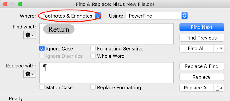

Re: Find return characters in footnotes and replace with pilcrow
Ah great, then this is a relatively straightforward task. You want to change your Find dialog "where" setting to "Footnotes & Endnotes". Once that's done just insert what you want to find (returns) and replace (pilcrows), and then click "Replace All". It should look like this:
