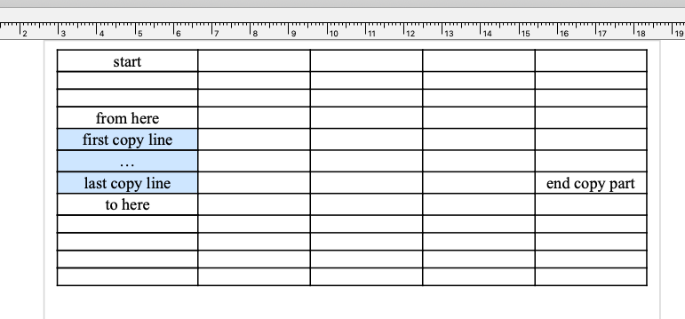

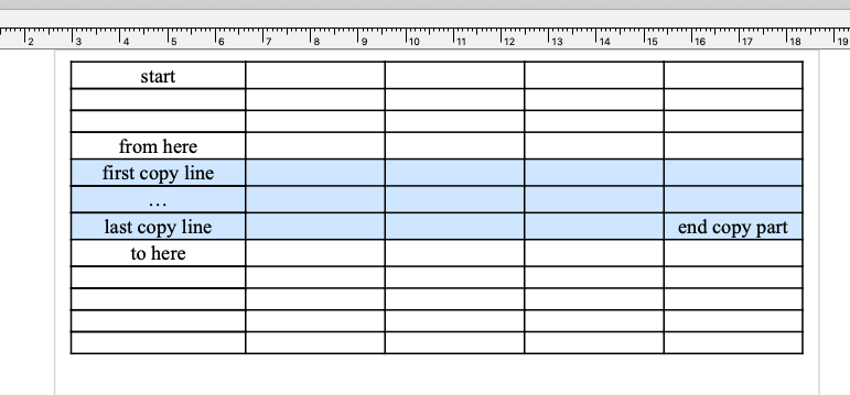

But here are some screenshots from my own attempt to follow my procedure.
Select the cells
Screen Shot 2020-04-27 at 24.17.50 .png (31.56 KiB) Viewed 10128 times
Select the rows
Screen Shot 2020-04-27 at 24.18.05 .png (31.28 KiB) Viewed 10128 times
Cut the rows
Screen Shot 2020-04-27 at 24.18.16 .png (23.79 KiB) Viewed 10128 times

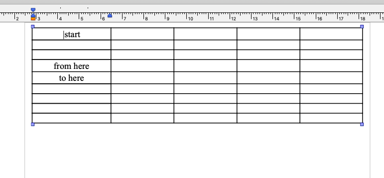

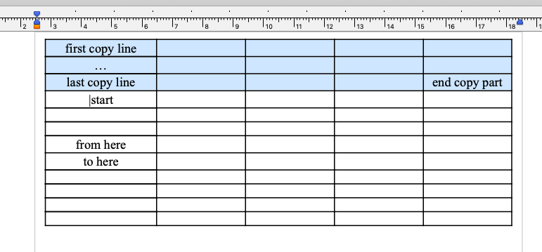

Re: Copy-and-paste table-rows
Place the insertion point
Screen Shot 2020-04-27 at 24.18.48 .png (24.81 KiB) Viewed 10128 times
Paste
Screen Shot 2020-04-27 at 24.19.09 .png (32 KiB) Viewed 10128 times
