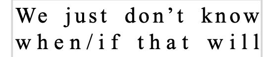

Here's a quick tip from our recent blog post on how to keep text together using a zero-width joiner character. You can insert the joiner between two characters to ensure those neighboring characters appear on the same line. This is useful in situations like this:
In the above screenshot you can see that the words "when/if" have been split between two lines. If you place the insertion point (aka caret) after the slash and use the menu Insert > Special Character > Spaces > Zero Width Joiner the joiner will ensure the slash and "i" are kept together. The line wrapping point will be adjusted like so:
