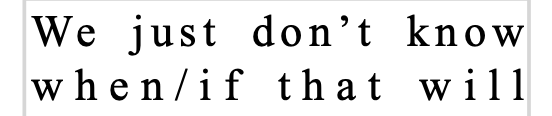

Here's a quick tip from our recent blog post on how to keep text together using a zero-width joiner character. You can insert the joiner between two characters to ensure those neighboring characters appear on the same line. This is useful in situations like this:
In the above screenshot you can see that the words "when/if" have been split between two lines. If you place the insertion point (aka caret) after the slash and use the menu Insert > Special Character > Spaces > Zero Width Joiner the joiner will ensure the slash and "i" are kept together. The line wrapping point will be adjusted like so:

adryan wrote: ↑2020-05-04 23:12:08It’s not actually zero width, as Align Justify will (usually) demonstrate.
In a quick test it seems to me that the zero-width joiner does not affect how full justification spaces the line:
In the above screenshot the zero-width joiner is again after the slash and before the "i" in "if", but you can see the letters remain equally spaced. There is no additional space allocated for the zero-width joiner. Or did you mean something else?
