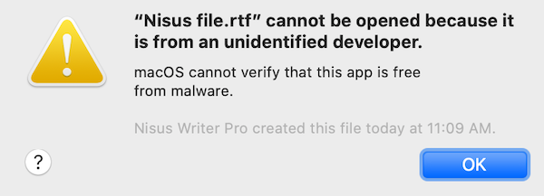

When you try to open a previously saved Nisus Writer file using the Finder (eg: by double clicking the file's icon), you might see a warning alert like this:
The warning claims that the file "cannot be opened because it is from an unidentified developer". This is false. Nisus Software is part of the Apple Developer program. We sign and notarize our apps as required by Apple to properly identify them.
So why is the Finder showing this warning alert? Ultimately we don't know, since it's controlled by macOS. But the most likely cause is that the "Open with" settings for the file have been edited. Changing which app opens an individual file seems to trigger this misbehavior (bug?) in the Finder. For more details you might read this article on the underlying technical issues.
