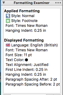

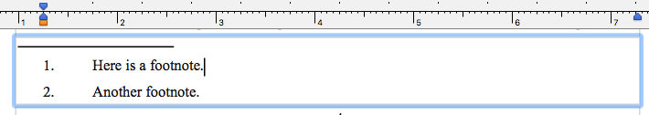

The footnote and endnote styles are set with a .25" hanging indent; the "Normal" style has a first line indent of .25"; the compiled RTF is marked as follows:
Screen Shot 2020-08-29 at 15.50.07.png (41.31 KiB) Viewed 43778 times
so they display as:
Screen Shot 2020-08-29 at 15.53.24.png (16.79 KiB) Viewed 43778 times
I want to find a way of making them all have the "Footnote" style hanging indent, without having the "Normal" style first line indent as well. That is why I said "respect the ruler".
phspaelti wrote:Why do you have to use select "All in this style" to select the notes. The notes reside in the special "fulltext". You can just click in a note and do "Select all" twice to get all the notes.
That works for the actual notes and I can adjust the indents that way, but I'll experiment with the code you give below. But it doesn't work for the markers in the text; it is there that I have had to select "all in this style. That said, I have actually been looking through the Macro Guide and have succeded in modifying my existing macro to deal with the markers the way I want.

xiamenese wrote: ↑2020-08-29 12:28:59 The footnote and endnote styles are set with a .25" hanging indent; the "Normal" style has a first line indent of .25";
You can do that by selecting all footnotes and removing the undesired paragraph style(s). Here are the steps if you do it manually:
1. Place the selection/caret inside any footnote.
2. Use "Select All" to select the entire footnote.
3. Use "Select All" again to expand the selection to all footnotes in your document.
4. Use the menu Format > Paragraph Style > Remove Paragraph Styles
That will clear away all applied paragraph styles, leaving only the Footnote style intact to enforce whatever paragraph formatting your style sheet defines. If you want to run a macro that accomplishes this task, here's some code:
$doc = Document.active
$notes = $doc.footnotes
If $notes.count > 0
	$noteText = $notes[0].fullText
	$doc.setSelection($noteText)
	Menu "Format:Paragraph Style:Remove Paragraph Styles"
End
