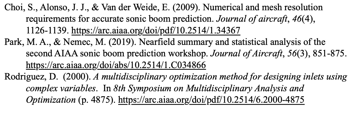

I'm new and am giving NWP a test drive. One of the first things I tried is to make a bibliography with Bookends. Put in a couple references...a journal and a conference paper. It builds the bibliography and it looks ok, until it goes past the Journal title which is italicized. After that, the entire bibliography becomes small caps for no apparent reason. See attached. Any ideas how to fix this? I'll be honest, if NWP doesn't play nice with Bookends, I won't be able to use it. Thanks.

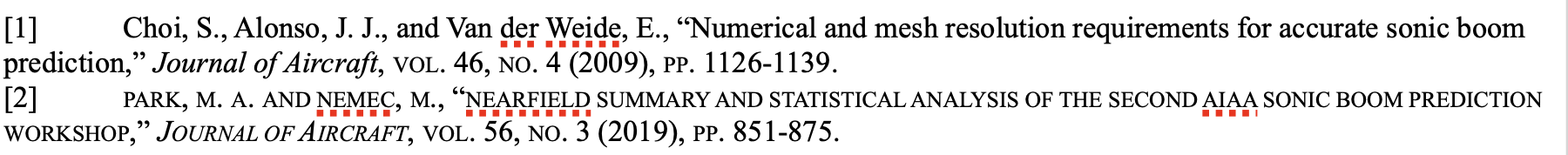

Hamid wrote: ↑2020-10-25 00:45:26 What format is applied to the bibliography?

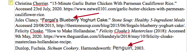

I don't have that problem with italics, but, using "Chicago 15A" I find a few odd stretches appearing in a different font. The same stretches appear on the Bookends even if I change the format, or enter those stretches in Bookends itself. For me, it's easy to solve, but there's obviously something going on in Bookends. Here's a screenshot:
Screen Shot 2020-10-25 at 11.35.42.png (54.15 KiB) Viewed 31103 times
I'll report this to Sonny Software.

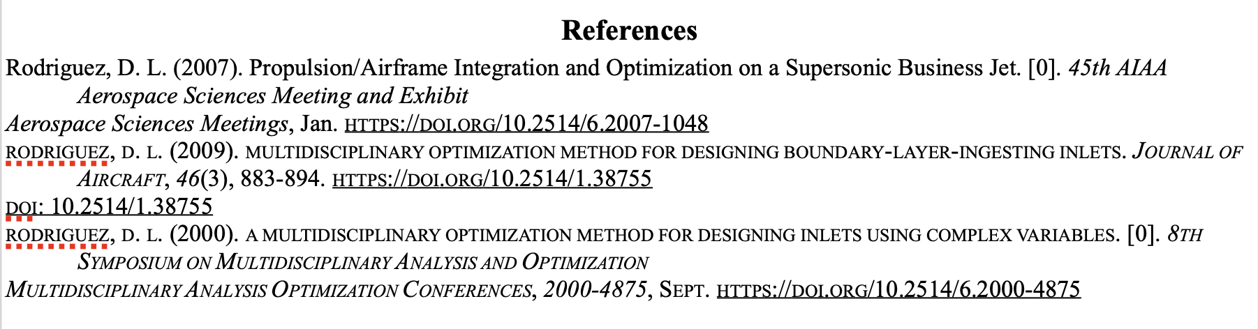

I have tried 2 different formats: my own that I have built over the years for my AIAA papers and the standard APA 7th that comes with BE with no alterations. Here is what APA 7th looks like (same problem):

Re: NWP and Bookend - Case issues
Here is how my APA 7th appears:
This is why I think it's a Bookends problem not a NWP problem. For me this only happens in two of my entries; the rest are as required.
