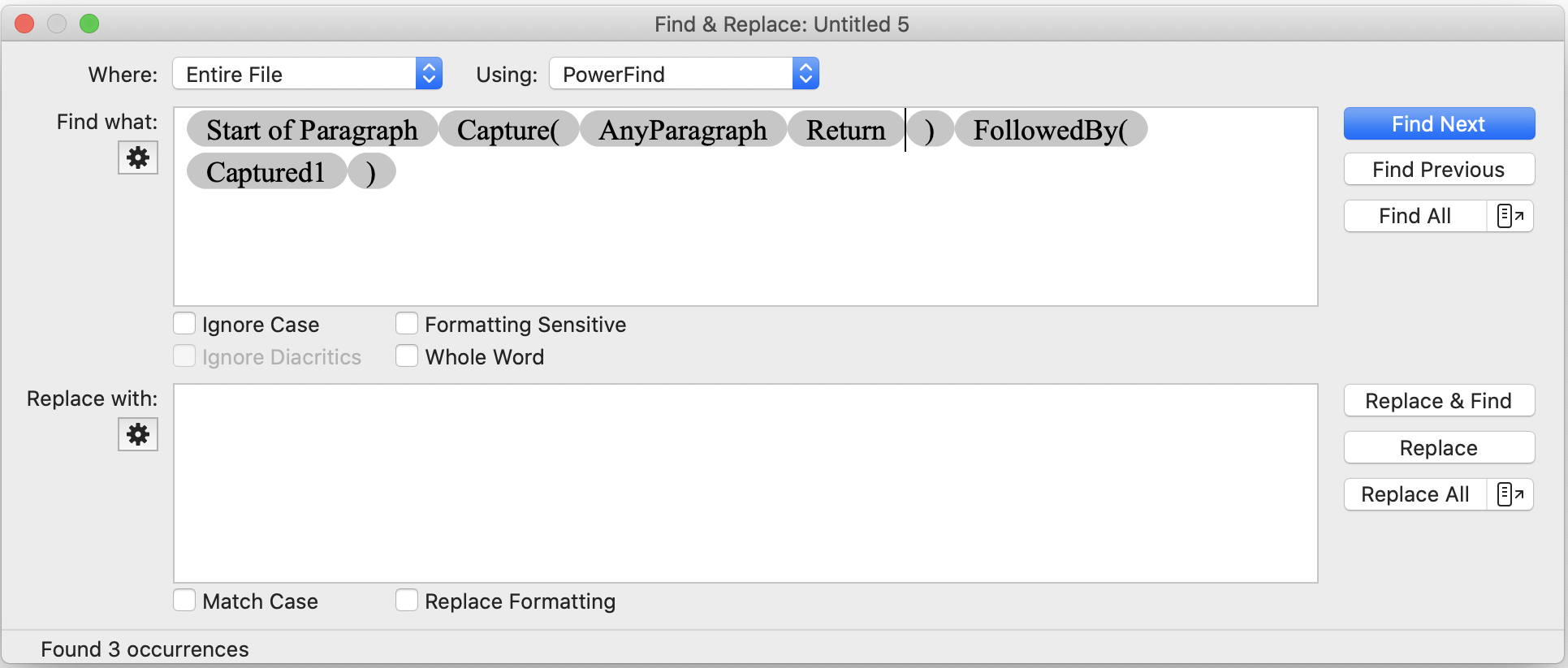

Since you have the headlines already with a style you can just keep those and delete the ones before them. So find paragraphs that are followed by an identical paragraph. In Powerfind this will look like this:
Find Preceding Duplicate Paragraphs.jpg (118.81 KiB) Viewed 28783 times
