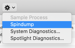

Please let us know if you learn anything from the Bookends side of things. Otherwise I might ask that you collect an Activity Monitor "spindump" while the problem is underway. Here's what you can do:
1. Trigger the problem, where you're waiting endlessly for the scan to complete.
2. Launch Activity Monitor.
3. Click the gear icon in the toolbar and choose "Spindump" from the contextual menu.
That will generate a big report of all activity on your Mac. You can save it as a text file and email it to us at:
