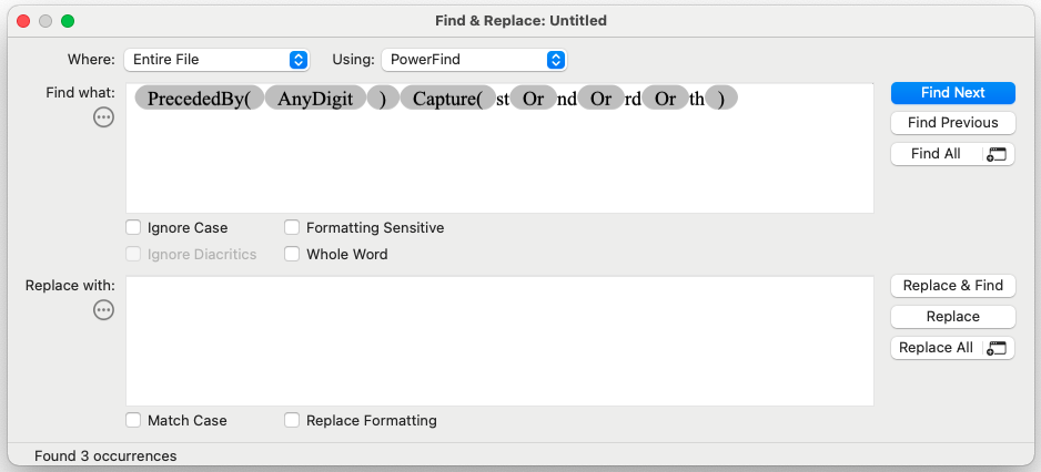

Adrian's explanation are fine, but the first step I recommend when you are getting "Found no occurrences" on a styled search, is to turn the "Formatting Sensitive" off. Make sure to try "Find next" or "Find All" rather than "Replace All" at that point. And since in fact there is a good chance in most documents that this will be finding exactly what you want—since most documents do not mix numbers and letters in this way otherwise—you'll have what you want.Frank Einstein wrote: ↑2021-01-16 12:31:59 I am having no luck trying to follow your suggestions--probably something I am doing wrong.When I follow your instructions, I get the "Found no occurrences" message from NW. So I am guessing that I am doing something wrong in the Find box. Here is a screen shot. Can you see anything I have done wrong?
The truth is "Formatting Sensitive" search can often be avoided. And I recommend avoiding it whenever possible.
Here is the find expression I recommended earlier. With this you can just change the formatting rather than use "Replace All"
