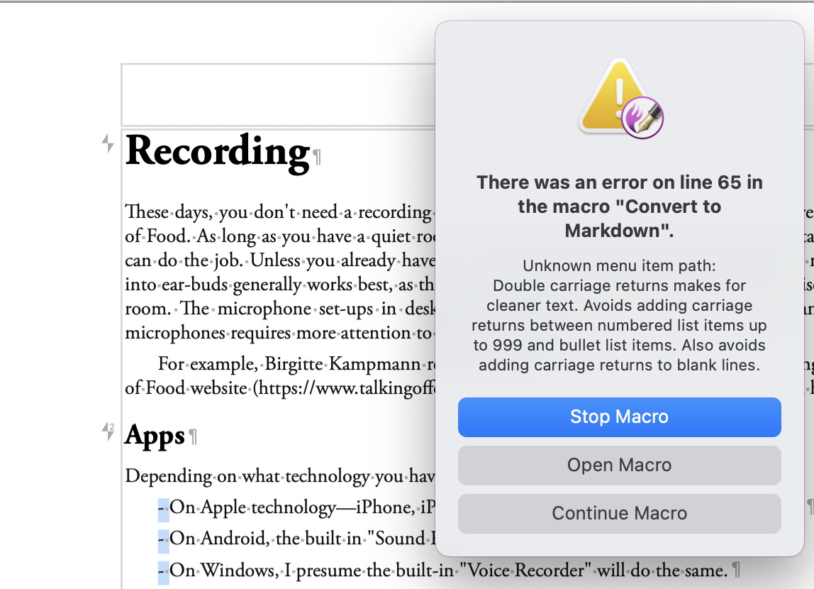

I've just tried your macro, as well as the other one by @tomoyuki-kosaka on a file with headings, bold, italics and bullet-points.
The @tomoyuki-kosaka macro worked, so I copied the result and pasted it into a plain text document which I opened in Marked2; it looked fine except that the bullet points were not properly rendered. I was able solve the problem by simply editing the .md file I created and replacing single carriage returns with double.
Your macro threw an error as follows:
Screenshot 2022-12-31 at 12.41.jpg (213.83 KiB) Viewed 34275 times
If I "continue" the macro, the text has had the double carriage returns inserted, but only the text without any of the markdown code is placed on the clipboard.
I'm happy to be told I'm doing something wrong.
P.S. I tried doubling the carriage returns myself in NWP before running the macro. Still getting the same error alert.

Mark, Thanks for letting me know. I forgot a # in front of the comment line. :P It works now. 8)

loulesko wrote: ↑2022-12-31 10:32:12 Mark, Thanks for letting me know. I forgot a # in front of the comment line. :P It works now. 8)
Lou
Hi Lou,
Glad to have helped.
I’ve again tried the two macros on the same document. As I said, for @tomoyuki-kosaka’s macro, I need to substitute double carriage returns for the single carriage returns used in the RTF, together with a couple of other tweaks… very easy, and it doesn’t add paragraph spacing within the bullet lists.
For your macro, having inserted the # before that comment, it runs, but:
  • I still don’t get headings or bold/italics converted, but I think the reason is that in the style-sheet for your macro, the style statements are all defined as 12 pt and bold and italic with the latter defined as Courier Prime—presumably that is what you are using—and my styles have different sizes and either Adobe Garamond Pro or Times New Roman. I think that is the problem because @tomoyuki-kosaka doesn’t have either font or font-size specified in the styles. I haven’t yet tried removing those line from your macro style definitions, but will try.
  • Although your macro replaces single with double carriage returns, it doesn’t do so at the end of the line preceding a bullet list, at least not my bullet lists.
I don’t know if you want to spend the time sorting out these small issues in case anyone else is interested in using it, but, just in case, I attach a nonsense document for you to play with. When I have a moment, I’ll try dealing with them myself, though I’m very far from being macro-savvy.
