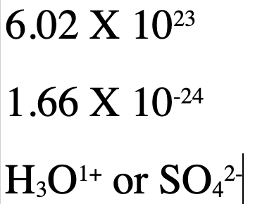

Hi, Patrick G,
I tried your macro. Thank you! Here's what I got:
Scientific Notation Sample.png (19.26 KiB) Viewed 121379 times
Because of your background teaching chemistry, I'll ask you (or others who may know): Do you know of a way in Nisus Writer Pro to do fractions such that the numerator is above a line and the demoninator below (i.e., not a slanted line fracton).
