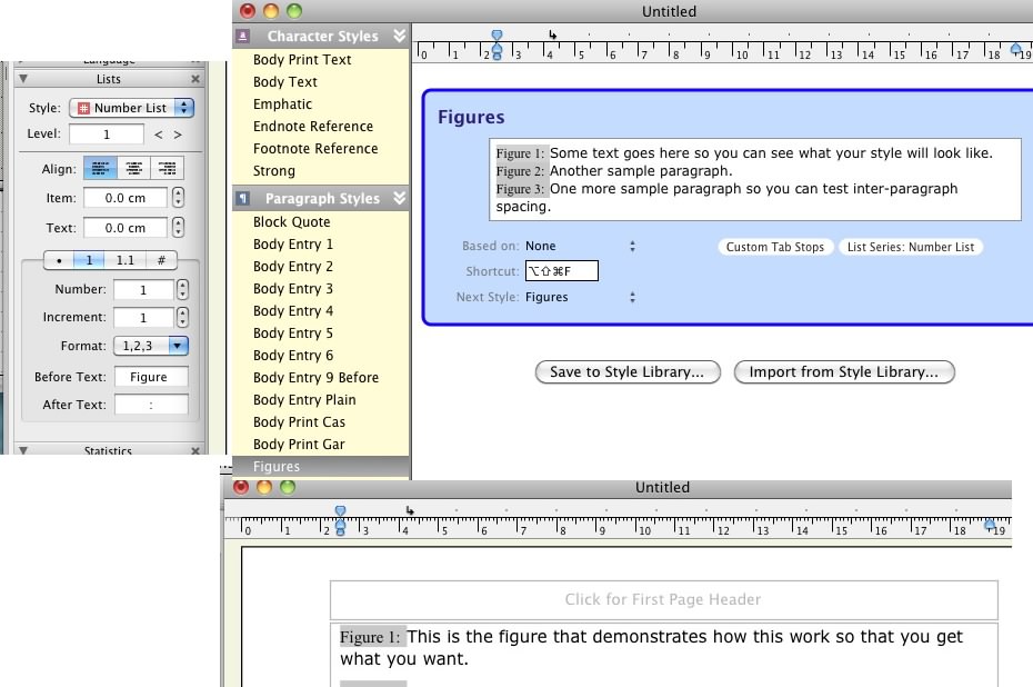

Thanks for the suggestions. Using the lower gumdrop I can adjust the indent; however, the left-margin drop follows the lower gumdrop, i.e. I can't return it to the left site. This is the result:
And this is how the style sheet looks:
Why can't I adjust the lowest blue drop left?

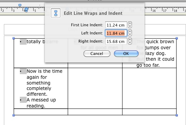

Regarding the measurements -- if you are entering zero in the dialog box that comes up from the gumdrops, you will come up against a problem. [bold]NWP is confused here, and it is something a number of us have raised and, Martin, it really DOES need to be fixed~!.[/bold]
The measurements you get in the ruler are different from the measurements in the lists palette. In left to right text, the dialog from the ruler gives measurements from the left edge of the paper, so if your left margin is, say, 2.5cm, then the minimum left indent is 2.5 cm, which actually equals 0 cm within the text block.
BOTH should give the measurements from the left margin, in my view, NOT paper edge, since the text block margin is is the primary guide for both text formatting and for reading in left to right script.
BUT -- the measurements given in the Lists palette are from the left margin ("Item" is first line indent/outdent; "Text" is left indent)
If you use the list feature within a table, it gets even more confused. Take the example shown in the attachment. Why are the figures so divorced from reality, Martin? This needs to be fixed too, and should give the measurements from the left margin of the column they are in.

For what my problem concerns, I don't care if the lower squared gumdrop is supposed to follow the triangled one. This is the result:
This is NOT what I want, I want it to look like this:
This is what it looks like without moving any of the gumdrops:
All I really want is to get rid of that indent.
So once again, in a proper tone, how do I do that?
