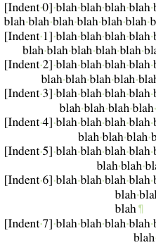

How about this? Instead of changing the amount of hanging indent staying in the same paragraph style, switching to another paragraph style having a larger hanging indent? In the attached rtf file, 21 paragraph styles from Indent 0 to Indent 20 are defined like this.
HangingIndentation_a_rtf.zip
(3.63 KiB) Downloaded 851 times
To switch, for example, from Indent 0 to Indent 1, from Indent 4 to Indent 5, etc., you can use IncreaseNumberedParaStyleLevel macro included in Outline_dot_Macros .zip posted as attachment to my posting here:
http://www.nisus.com/forum/viewtopic.php?p=19028#p19028
Also, you can switch from Indent 5 to Indent 4, from Indent 1 to Indent 0, etc. by running DecreaseNumberedParaStyleLevel macro in the same zip archive.
If this way of editing fits your needs (I’m not very sure), then, you would like to customize those Indent # styles.
 · The macros do not rely on specific paragraph style names. They just switch to a paragraph style of the same base name having a different number (+1 or -1) at the end. Under this condition, any style names are OK.
 · All Indent # styles in the rtf file are based on Indent style (without a number). Changes in Indent style, e.g. amount of first line indent, font size, line spacing, etc., will be reflected in all Indent # styles.
EDIT: I replaced the attached rtf file with a new one. In the older file, irrelevant styles such as Header, Footer, Footnote, etc. were inappropriately based on Indent style.

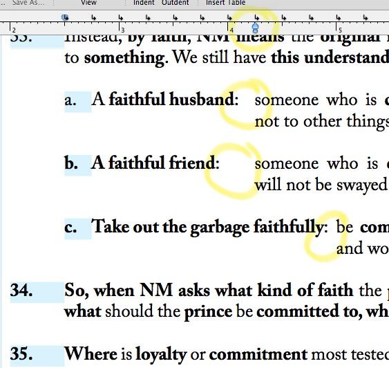

Thanks again, this certainly gets me towards what I was looking for. Unfortunately, I need the #indent styles to work on any level of the list style. Here is an example from (yesterdays!) lecture notes to illustrate what I mean:
NWP Indent Screen Capture 3.jpg (63.24 KiB) Viewed 21927 times
In this example, I am using indents on the second level of the list style (I've manually moved the left indent marker each time I need it), but I also use it on the first and third (or whatever) levels too. (I've gotten into the habit of formatting the lectures this way because WordPerfect, which I used previously, would allow you to insert a hanging indent code anywhere in the line with one keystroke that would give you this effect).
However, I can only get your otherwise very helpful #indent styles to work on level 1 on the list style and not on any others.
Thanks for all your efforts on this.

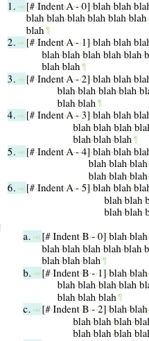

Posts: 400
Joined: 2008-05-17 04:02:32
Re: Automatic advance of Left Indent . . .
Post by Kino »
Now I see. I have been wondering how you use hanging indent and why you stick to it. I’d like to have looked at the image — or rather an attached sample document file — in your very first posting. That must have simplified many things.
Anyway, hopefully this one will meet your needs.
IndentedNumberLists_20110206_rtf.zip
(7.86 KiB) Downloaded 856 times
In the attached rtf file, (?:# )?Indent [A-I] - [0-5], i.e. Indent A - 0, Indent A - 1, Indent A - 2, Indent A - 3, Indent A - 4, Indent A - 5, Indent B - 0 . . . Indent I - 5 and their counterparts having a list style, i.e. # Indent A - 0, # Indent A - 1, # Indent A - 2, # Indent A - 3, # Indent A - 4, # Indent A - 5, # Indent B - 0 . . . # Indent I - 5 are defined, for which Increase Numbered Para Style Level and Decrease Numbered Para Style Level macros work.
If ‘Indent . . .’ or ‘# indent . . .’ styles already defined in the rtf file are not sufficient, I think it would not be so difficult for you to add new ones. As you see, in those styles, A-I correspond to List Style’s different Levels and 0-5 to different amounts of hanging indent.
