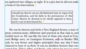

Thanks, Martin, but I meant something a little different. Like in this screenshot:

Screenshot 2011-06-29 at 3.54.42 PM.gif (19.9 KiB) Viewed 6091 times

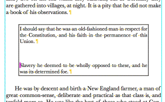

I just set space before and space after (in Paragraph palette) to a convenient amount. All very well with a single paragraph. But with two or more paragraphs, the space applies between paragraphs too. Like this:

Sure I can apply different spacing to first paragraph, last paragraph and those in between. Or apply special space to the paragraphs that come before and after. Feasible. It just takes some doing. That’s all. I just hoped this could be done more easily through the shading formatting.

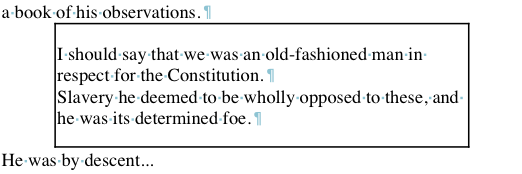

Re: Spacing Around Borders
Ah, okay, so really you want a separate "between paragraph" spacing that is only used when two adjacent paragraphs have the same paragraph style applied. Basically an intra-paragraph-style spacing that overrides both the before/after paragraph spacing. That would be a useful feature, and I'll file it as an enhancement, thanks!
Though you can get somewhat close to what you want with paragraph borders. It's just that the spacing is applied within the paragraph borders, not the outside:
Not the prettiest, but perhaps it would do.
