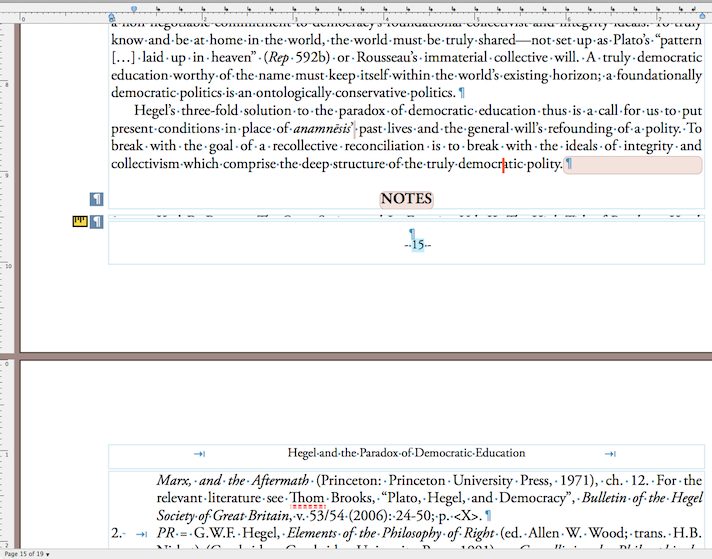

This post is more in the way of mentioning a small bug with NWP than asking for a solution (although if there is one, I'm happy to receive it!). I've occasionally noticed a problem when a document has endnotes which are placed at the end of the document. If the end of document comes near the bottom of the page, NWP will try to display the first endnote in the remaining space, even though there is not enough vertical room to do so. The result, the first footnote gets cut off. I've attached a screen capture of the problem.
The work around is easy enough (insert a page break), but I thought I would mention it anyway for the future.

Thanks Josh, this is a bug and one I can reproduce. I'll file it for fixing, thank you.
