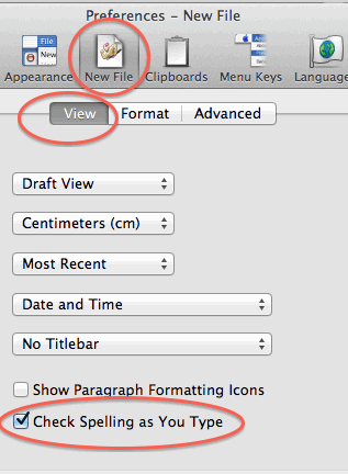

hatchmo wrote:I maintain that it was a mistake for Nisus to make "Check Spelling as You Type" effective only on a per-document basis.[...]
You can set it for all documents in NWP Preferences:

That checkbox can set it to be ON for all new documents,
but it doesn't work to set it OFF for all documents.
Most of us want it off, not on.
Al Hatch

hatchmo wrote:That checkbox can set it to be ON for all new documents,
That's not true. If you turn off "check spelling as you type" in Nisus Writer's "New File" preference pane, any new file you create will have inline spellchecking disabled.
But you are correct that the setting only applies to new documents. Existing documents store the setting in the file itself, just as with other view settings, eg: Draft vs Page view, show rulers, show invisibles, etc. We believe that saving the document view/editing state on a per-file basis is a useful feature.
