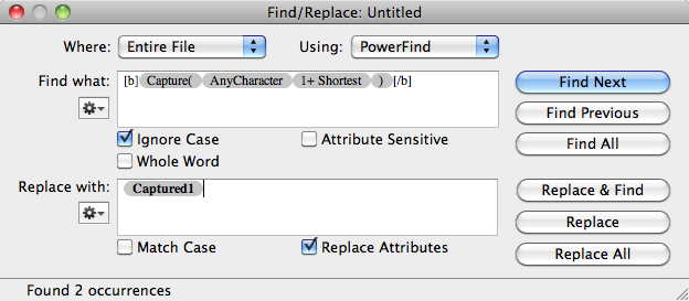

The find box should look like this:
If you do "Replace All" now on a file with that kind of mark up you should have your mark up turned into formatting.
NB: Since "Ignore Case" is checked, this will work for tags with either "b" or "B" in any mixed combination. (This seems to be what you want.)

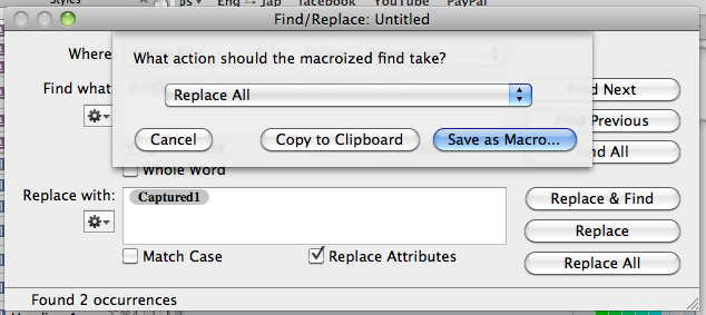

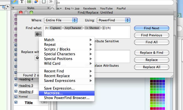

To get a macro, you do the following.
  1. From the gear menu choose "Macroize…"
    choosing "Macroize…"
  2. In the macroize window specify "Replace All" and then do "Save as Macro"
    Save as "Replace all" macro
