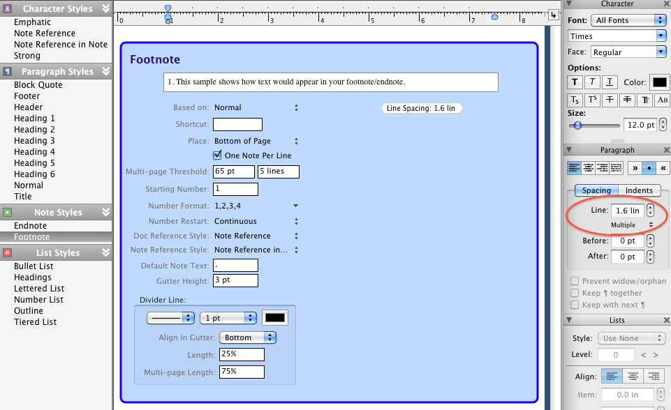

Re: Change line spacing/height in footnotes?
That shouldn't be too difficult. All footnotes in your document will automatically have a Note style applied. Usually this style is called simply "Footnote" (though any name is possible). Whatever that Note style may be called, you will want to adjust this style so it enforces the desired line height.
Visit your document's style sheet (eg: use the menu View > Style Sheet), select the Note style, and then simply adjust the line spacing. You can set the line height to any fraction/multiple of the line height, eg: you might try a multiple of "1.6"
