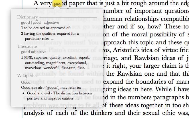

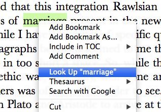

When I 'Look Up' a highlighted word that is near to the beginning of a paragraph, Look Up works perfectly (see the attached 'Look Up Okay After' for the expected results). However, as I try looking up words farther from the beginning of the paragraph a consistent weirdness erupts. Look Up shows the desired word highlighted and in context menu (see 'Look Up Problem Before') but actually looks up the end of the previous word and the first characters of the desired word (see 'Look Up Problem After').

LOOK UP OKAY
Look Up Okay After.jpg (91.86 KiB) Viewed 11362 times
LOOK UP PROBLEM BEFORE
Look Up Problem Before.jpg (34.84 KiB) Viewed 11362 times
