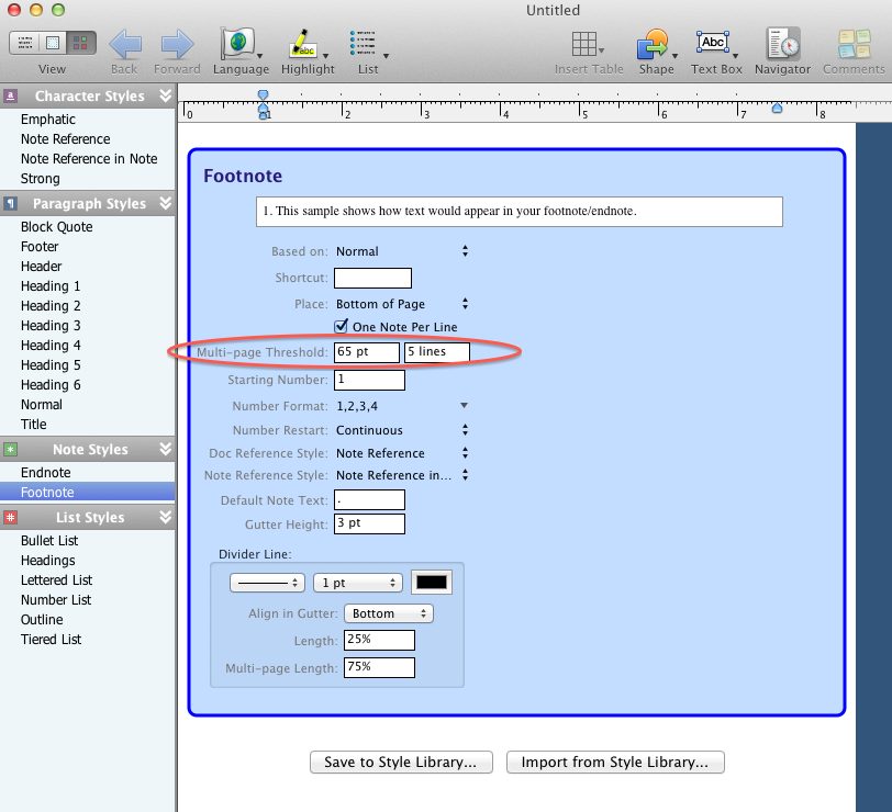

About a third of the way down: "Multi-page threshold".
Re: Footnote Questions
ryentzer wrote:I don't see where I'm able to adjust the height of footnotes. Where is this located?
Mark is correct, it's about 1/3 of the way down in the Note style properties:
You can get to that document view by using the menu View > Style Sheet and then selecting one of your note styles from the list on the left.
The limits work by enforcing a maximum height. If a footnote ever becomes larger than this maximum height, it will flow across multiple pages.

I'm not understanding how it is applied. I can change the settings for example from 65pt and 5 lines, to 30pt and 3 lines and not see any difference. I set up a test file with long footnotes to see how it works but I'm obviously doing something wrong. What does the first of the two settings for the multi-page threshold control?
In the screenshot of the test page, the settings of the multi-page threshold are 12pt, 2 lines.
Thanks, Rick
ryentzer wrote:I'm not understanding how it is applied. I can change the settings for example from 65pt and 5 lines, to 30pt and 3 lines and not see any difference. I set up a test file with long footnotes to see how it works but I'm obviously doing something wrong. What does the first of the two settings for the multi-page threshold control?
You probably aren't doing anything wrong, I just didn't explain very well what the note "multi-page thresholds" control. Sorry about that; let me try again.
The thresholds do not directly control how tall the footnote area at the bottom of each page will be. They also do not directly control the height of any single note. Instead these thresholds simply specify the conditions under which a note may be split so it spans multiple pages (eg: a single note's content flows from one page to another). I said "may" because a note won't be split across a page if it fits nicely on a single page. So a better definition of the thresholds would be that a single note shorter than the thresholds will never be split between pages.
Looking at your screenshot, you can see footnote #6 is at least 4 lines, which is larger than your multi-page threshold (2 lines), so it would be allowed to span multiple pages. However, since there's plenty of room on the page for footnote 6, Nisus Writer isn't going to split it.
I hope that makes sense. Please let me know if you have any questions.
