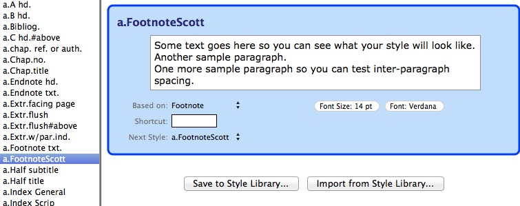

Thanks for your help. Because I'm a style neophyte, I have to go back to the beginning question. I have a document with original footnotes that need to stay with their original format. I have selected them all and made them uniform.
Now, I need to be able to add new footnotes in a different format. The doc I have came over from Word, and I have copied the footnote style that I have been asked to use (see screenshot). Now I don't know how to make this the new, default style for all added footnotes, and to include my initials in every footnote. So, according to the style on the screenshot, the new footnotes will need to be in Verdana 14, and to have my initials at the beginning of each footnote text. I just don't know how to make that happen in this Nisus document. Can you tell me what steps to take to make this style the new default for all new footnotes? Thank you.
- Screen shot of footnote style brought over from the Word doc. Initials need to be added to every new footnote text.

Re: 2 footnote fonts?
So technically speaking the style in your screenshot is not a Note style, it's just a Paragraph style. In Nisus Writer document's there's only one Note style (typically named "Footnote") that is applied to all footnotes. This style is always enforced for all footnotes, regardless of when they were created, and cannot be removed (because it also controls things like note numbering, heights, etc).soliphint wrote:Now, I need to be able to add new footnotes in a different format. The doc I have came over from Word, and I have copied the footnote style that I have been asked to use (see screenshot). Now I don't know how to make this the new, default style for all added footnotes, and to include my initials in every footnote. So, according to the style on the screenshot, the new footnotes will need to be in Verdana 14, and to have my initials at the beginning of each footnote text. I just don't know how to make that happen in this Nisus document. Can you tell me what steps to take to make this style the new default for all new footnotes? Thank you.
So, technically what you want to achieve is that new footnotes you insert have both the "Footnote" Note style applied (which happens automatically), plus your "a.FootnoteScott" paragraph style. You also want to insert your initials as the default text. As mentioned before, this is most easily done via a macro, which would be amended to:
Menu 'Insert:Footnote'
Menu 'Paragraph Style:a.FootnoteScott'
Type Text 'SCOTT '
