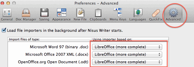

It may be that your import filters need to be set correctly to give a more complete import.
Set the filters to LibreOffice from NWE Preferences=>Advanced:

Thanks Hamid--these options are grayed out in my dialog box. How can I get access to them?
Re: .doc files and footnotes
The image in my post is of NWP 2.0.4.
I am assuming that it is very similar in the latest version of NWE
In any case, NWE does have:
Microsoft Word ".doc" (97-2004), import and export, while DOCX, import-only is limited and requires [at least] Mac OSX 10.5 (Leopard)
according to http://nisus.com/pro/comparison.php

The screen in my dialog looks exactly like the image you posted, it's just that the boxes within the red border on your image are grayed out, and read 'Mac OSX (faster)' with no access to a pulldown menu.

Thanks for your help Hamid, but in this case Nisus Writer Express is slightly different than Nisus Writer Pro.
Nisus Writer Express will only import .doc files using the OSX importer, which does not import footnotes as proper note reference/text combinations, but only extracts the footnote text and places it at the end of the document without a reference number. On the other hand, Nisus Writer Pro includes the full LibreOffice-based importers, which do import footnotes/endnotes as proper reference/text pairs that appear inline inside the full text body.
