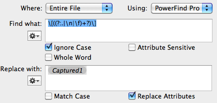

I want to change [this] to this, or [this] to this, or [this] to this, i.e. text with brackets to italicized text. However, sometimes the target text in brackets already has bold, underline or such applied. All I want is to add italics. I'm using the PowerFind Pro find and replace formula in the attached screenshot. However, if the text has other attributes applied, it removed them and adds back italics only. How can I get want I need? Do I need to do separate find/replace functions for differing text, i.e. one for text already in bold, one for text already in bold & underline, one for text that has no attributes applied yet, etc.?

Hi I have fixed your macro.(Keeping my fingers crossed.) If you do it right then you don't need three Find/Replace statements. Your last one will suffice.
What does "do it right mean"? Well the attribute sensitive find/replace pays attention to the attributes. All the attributes. So once you paste the statement into a file it takes on other attributes (paragraph style, for example), and then it stops working. The solution for such cases is to use the "Remove Attributes and Styles" command, and then add back just the attributes you want.

Anyhow I hate fussing with the attributes so I suggested a second method.
As I described above, you can use Find/Replace to select things, and then apply the styles you want. As long as the Find part doesn't care about styles, this works, a bit more "reliably".
A macro can contain more than just a list of Find/Replace statements. You can add any menu commands (just type them exactly as the menu name says), and then there is a whole macro language if you want to get really elaborate.
