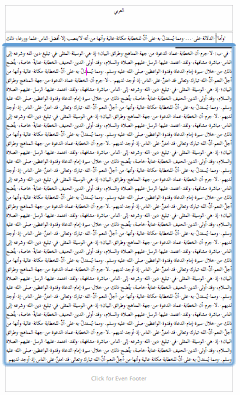

You can have a really long footnote by using the “Keep ¶ together” option like in the example here, where the body is just one line, the rest being a long footnote:
However, the “Keep ¶ together” option is dimmed for the note style and cannot be applied to it alone, and as the note style itself is generally based on your Normal style, applying “Keep ¶ together” to Normal style (to apply it to the note style dependant on it) is rather awkward.
A workaround is to create a duplicate style of Normal, say Normal1, which will not be used in the body of the document. Add the “Keep ¶ together” attribute to Normal1, and make your Footnote style be based on Normal1. Then, the “Keep ¶ together” attribute will automatically apply to Footnotes and keep a long footnote (which is less than one page long) on the same page.
