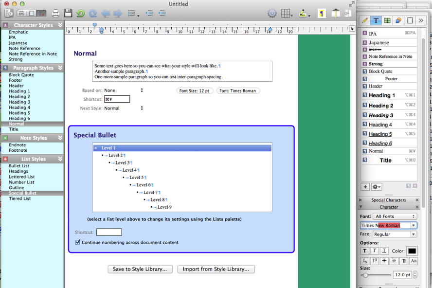

Otherwise to set the font or size of the bullet, you should make sure to apply this to the relevant level of the list definition in the style view. This does work for me.

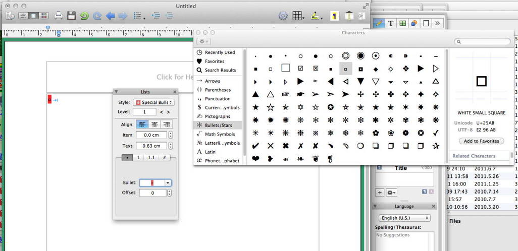

Re: Changing the Size of Bullets in a List
Here's how I type directly into the bullet pull-down menu in the list settings. (Note: this will only "take" once you move the cursor to a different field of the list settings.)
Nisus Custom Bullet.jpg (68.85 KiB) Viewed 11525 times
Here is how I format the bullet in the style menu.
Nisus Format Custom Bullet.jpg (88.99 KiB) Viewed 11525 times
Here is the result
Custom Bullet.rtf
(21.24 KiB) Downloaded 499 times

Again, many thanks, Philip.
I'll give that a try today.

Philip,
I followed your first example, and it worked. As you said, it only "takes" once you move the cursor to a different field of the list settings. I was able to make the change, save the document, and have the changed bullet appear when I opened the saved document.
I'll try the style menu when I am more familiar with how it works.
