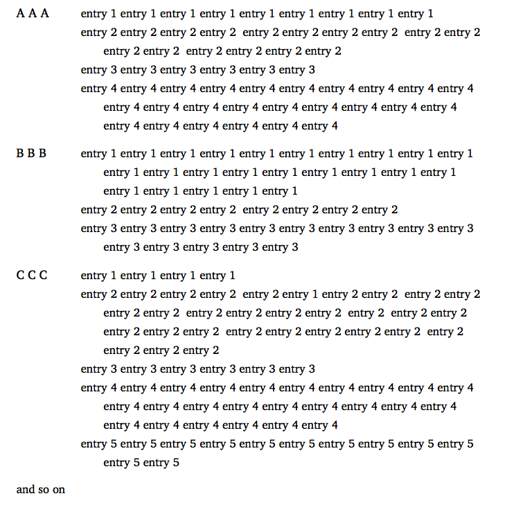

Hello together,
I want to create a document which is formatted like the example attached. How do I have to set the indents and the tabs? AAA, BBB, CCC, ... should be paragraphs with additional paragraph spacing. Inside AAA, BBB, CCC, ... there are soft returns. My problem is, that I have two different left indents.

Thanks, Philip,
yes, of course this is a solution. But it is not very elegant. I hoped, that something more sophisticated exists. Your solution destroys the logical structure of my document, because I loose the exclusive paragraphs AAA, BBB... (which will be the main entries in a dictionary). So I prefer to abstain from the second line indents of the subentries. (The final formatting will be probably quite different, I wanted only during my work in progress to see things clearer and more structered on the screen).

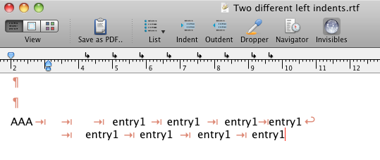

Actually I need to do something like this sometimes, so I use soft returns which can be very useful...
Use a style, put appropriate tabs (NWP has 4 types) at each indent point (so double the number) and use soft returns - very useful. This means that if your second line content is shorter than the tab interval, you'll need to put an extra tab in the content, but apart from that...
Here's an example and the file is attached... warm regards
Cris
