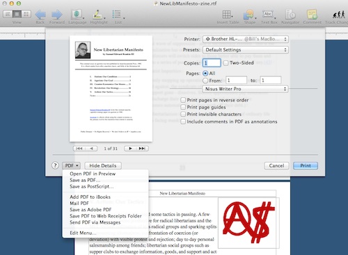

I use an option in the print dialog. If you select the PDF menu in the lower left of the dialog, I at least have an option Create Booklet (see screen shot). It creates a temporary PDF which is already imposed.
Screen shot of PDF menu
Screen Shot 2014-01-17 at 9.59.00.png (43.83 KiB) Viewed 17601 times
I think it's a standard thing, as I can't find an installer for it on my computer, so the price is right!

Thanks, JHB, but on mine there is no such menu item.
I have Nisus Writer Pro 2.0.7
Maybe I need a postscript printer for that option to show?
