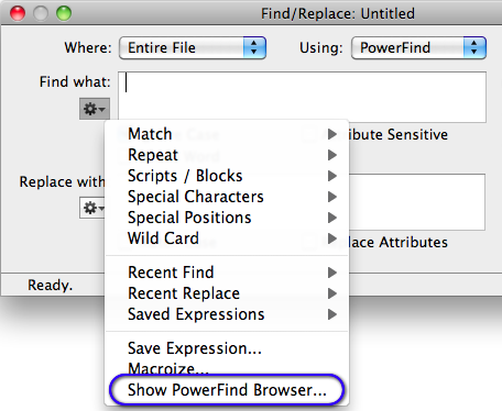

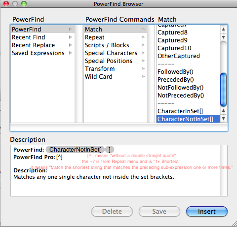

I didn't know there was a way to see what each PowerFind expression looks like when it's converted to RegEx (PowerFind Pro). What a relief to find it! (Last item under gear in Find/Replace box)
So now I know that …
[^"] is RegEx for the Match menu item CharacterNotInSet and it "Matches any one single character not inside the set brackets."
+? is RegEx for Repeat menu item +1 Shortest and it will "Match the shortest string that matches the preceding sub-expression one or more times."
I kept thinking there had to be a list of those "translations" from PowerFind to PowerFind Pro, but I couldn't find it in the manual. Whew! Relief.
Now I understand why your macro works, Martin. I'm a happy camper.
EDIT: added screen shots.
