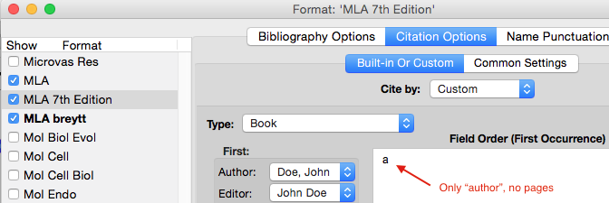

I guess the culprit may be your citation *format*. If you use the MLA format, for example, then page numbers will ALWAYS disappear when you scan the document, simply because they are not supposed to be there according to the MLA format.
If you want a page range to appear, you must change the format, or better still, create a new format based on the old one, and change "a" to "a,p-". The "MLA breytt" which you can see on the screenshot is such an altered format.
To change the citation format you must
1. go to Biblio > Formats Manager… in Bookends
2. Click on the "Citation Options" tab at the top of the right window
3. Select the correct Type from the Type pop-up menu.
4. In the "Field Order" field you will see how your final citation will appear after scanning.
