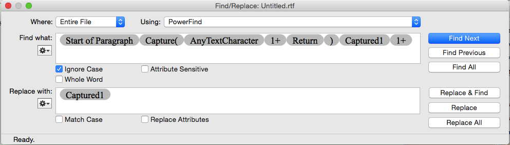

Don't need a macro. Find/Replace will do:
Find and Replace '^(.+\n)\1+', '\1', 'Ea'
Find identical paras.jpg (40.4 KiB) Viewed 13273 times

Excellent. Thank you, Philip. :-)

G’day, Þorvarður et al
Just for the record, note that Philip’s solution only works when the replicated paragraphs are contiguous. But one can easily ensure this by first using one of the Sort Paragraphs commands in the Edit menu.
