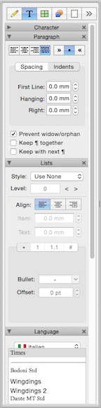

It seems that there is a bug on the Character Palette.
If you click the little triangle to collapse the palette, the palette closes but a " box ghost" with the list of the the fonts remain open above other palettes. Strange. Anybody else is having this issue?
A picture is attached. On the bottom the ghost palette.
Thanks
EDIT: It seems that many palettes are affected by this issue (Table cell shading, Languages, etc.). These are the Palettes that can be expanded down. This bug is confirmed in Yosemite 10.10.20. It is not present in Nisus 2.07.

Thank you for the screenshot Emilio. I've been able to reproduce the issue intermittently. It doesn't seem to occur all the time, or with all palettes, but I'm hopeful we know enough to fix the bug.Emilio_Speciale wrote:It seems that there is a bug on the Character Palette.

To help with solving the little bug of the ghost box on some palettes here is what I have discovered:
1. the bug is relative only to palettes that are extendable down: for instance Character and Languages etc.
2. the only palette of that kind that seems not to be affected by this bug is the Style Palette
3. this bug happens when you extend the palette down below and close it: a ghost box appears with part of the palette
4. it happens if you extend the palette down passing the below border of the document window
5. if you up the document window to make the ghost box disappear then the issue goes away
I hope this helps. Sorry if I am not clear. If you need a short video I can produce one.
Have a good day
thanks! The reset palettes terminal trick worked. Fine.
Have a good day
Re: Nisus 2.1 Character Palette bug. Confirmed
Thank you very much for those extended details Emilio. That's very much appreciated. I haven't been able to reproduce it with all the palettes you mentioned, but with your help I've managed to consistently reproduce the display error with the Character palette, so we should be able to squash this bug. Thanks again.
